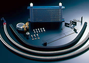

Default Can use for 07 or not and hard to fit it or not?
GReddy Oil Cooler Kit
GReddy/GREX Oil Cooler Kits help prolong the life of your oil and in turn your internal engine components. Hard driving causes higher engine temperatures. GReddy/GREX oil coolers are an excellent addition, and are especially effective in harsh driving environments. By using a similar inner-fin core design as our famous intercoolers, we are able to increase oil capacity, decrease oil temperatures, and extend engine and oil life. Our systems also offer an internal (or external) thermostat (opening range 71-85 C) to allow for quick engine warm up. The efficient core and durable steel-braided lines ensure good flow and a leak free installation.

Old Apr 2, 2008 | 05:09 PM
ColoradoClark's Avatar
ColoradoClark
Posts: 360
From: Colorado
Originally Posted by b7777
Please suggest which brand of oil cooler is good
use for HR
Thanks guy
What is the intended application? Are you planning on FI?
