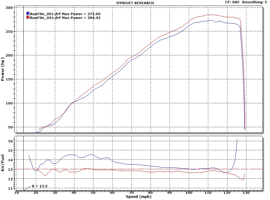

Default tuned at uprev today
I have to generate the charts... tomorrow.
the numbers are 285whp and 250 torque. (about that... tomorrow will be more accurate)
can't have the rpm working but 50mph is about at 3000 so every 16.6 mph is 1000
1000 = 16.6
2000 = 33.3
3000 = 50
4000 = 66.6
5000 = 83.3
6000 = 100
7000 = 116.6
7500 = 124.9

bump for chart

Damn those are decent gains for a tune for your mods. Area under the curve is nice. Congrats

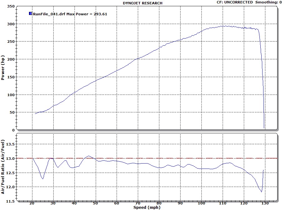

yep. than you know.. still a problem comparing apples to oranges (dyno and correction factors) from one to another.
if I put uncorrected values and less smoothing the peak power is about 294
just changing the smoothing to 0 you'll see 1 and something hp more.
I'm curious about headers, I know they work pretty well. but I'd like to have a header / cams combo
I guess my baseline full stock was around 260/265.. I'm quite happy with the gains and the "safety factor".

Great looking dyno sheet! Congrats!

2HP from one dyno to another? if you don't have HFC probably you're going to get 10 more hp on the dyno where your car was tuned in the first place.
even putting both our engines on an engine dyno we could end up with a 5% difference just for were we are in the tolerance of the engine itself.
the dyno should be used for what it is.. a tuning tool, not a reference.
I have seen people posting "uncorrected dyno chart with very low smoothing"... well...
here we go.
