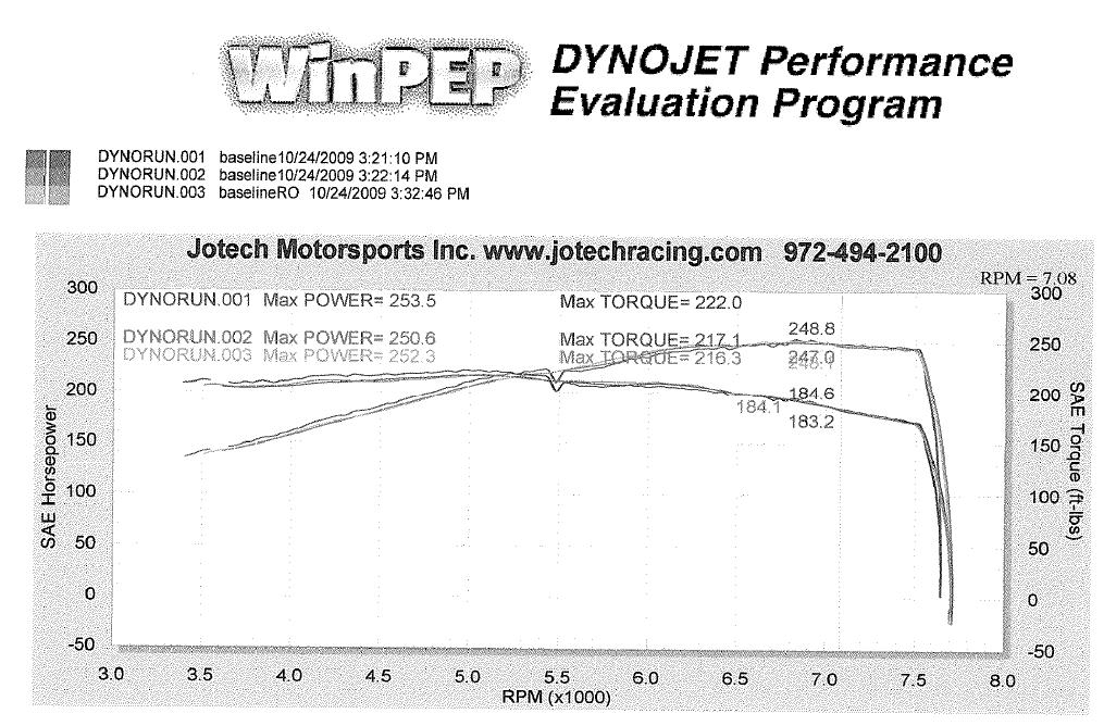

Here is the dyno...
1st pull was in 4th gear. The last two were in 3rd gear, which is why they are a bit lower. (more teeth = more drivetrain loss)

Why not in 5th? That is 1:1 in our cars.
Good question. There could be another 5 hp / 5 ft-lbs less drag going from 4th to 5th. That would put it a little closer to where I thought it would be.

well when I got mine dynoed at AAM before reflash I was at 274 or so I believe. one thing about doing a 5th gear pull without reflash is it's right at the 160 speed limit in the HR.

4th is 1:1 in the AT. 5th is 1:1 in the 6spd.
I dynoed my car today on a dynojet as well. I made 275 whp and 230 wtq with exhaust and intake. I'll post up a dyno sheet later.
They did the first run on 4th, but the car hit the speed limiter, so thats why I dynoed in 3rd for the last two runs. The 3rd gear dyno didnt make as much mid range hp/tq but seemed to make the same peak hp/tq as the 4th gear pull they started with.
Another reason is because you used SAE correction factor (which is actually the proper CF), and if you search, everybody that posts on here uses Standard correction factor which is always higher. Just changing the CF would probably give you 7-10whp on your graph.
