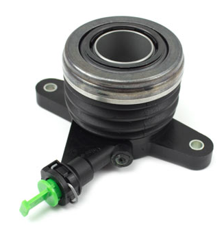

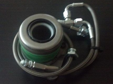

redline hasnt logged in for 2 years. anyway, i had an 08 and 6 weeks after buying the car (33k miles) it went out, i had the dealership replace for me and they obviously used oem.... fast forward a year and it went out again. i replaced it then with the zspeed hd one, along with the wilwood master and never had another issue. below are what they look like for comparison
oem
zspeed
you can see the obvious differences. where in tx are you?

IMO, if your needs are pretty much street duty with some occasional HPDE, A/X, that sort of thing, there's not much need to go with the Wilwood. Stock works fine with ZSpeed CSC.
But, if you believe all the hoopla about the stock master causing incessant pedal drop, go for the Wilwood or Tilton. (I've successfully used Mac Tilton's products for over 40 years - and have Tilton hydraulics in both of my project Datsuns - so I'm a little biased. )
There is also an alternative to the CSC altogether, also by ZSpeed, called the CMAK which converts the internal CSC to an external slave system similar to the DE setup. Supposedly works well, have not tried it but reviews are good here on my350Z.
