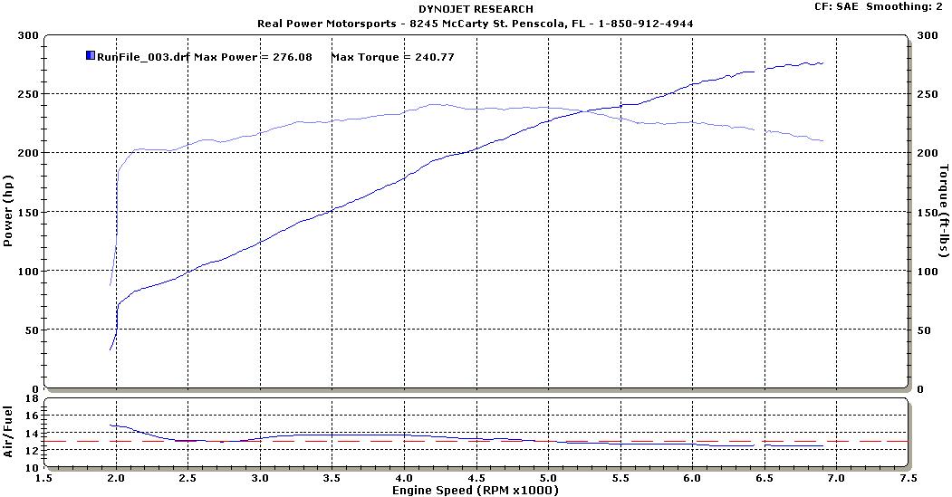

Sorry I don't have a stock baseline to compare it too, but it was a noticable difference. I'm using this as a baseline for my current engine build. Mods for this run:
Injen CAI's
HKS highpower
Stillen HFC's
Cobb Stage 2+
