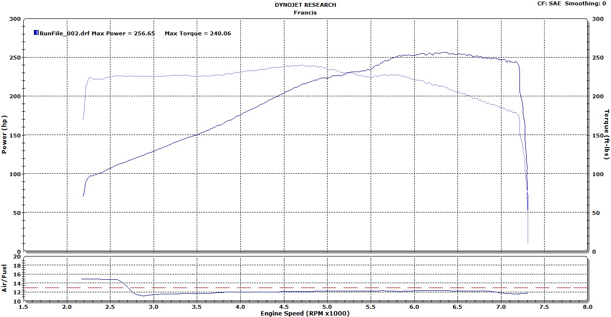

I went to the local dynojet and got a baseline of 256whp/240tq. The power is what I expected but I was surprised by the torque and have a quick question. Shouldnt my whp be higher considering my torque output? The powerband is very linear & I'm not complaining but I thought that the torque output was a little high. I did a search for bone stock baseline dynos and I dynoed 13-15 more torque that all cars with similar dyno results (255-260whp). My car wasn't pinging or pulling timing on the dyno. I have my dynosheet attached below.

The relationship for torque, speed, and horsepower is set by a formula. Given any two, you'll always get the other. See:
http://www.car-videos.net/articles/h...wer_torque.asp
I spot-checked a few points on your sheet, and the numbers come out OK.

so the HR has a drivetrain loss of aprox 20%?!!?

Not all dynos read the same, but thats around the norm for most RWD vehicles that i've seen Most AWD were around 33%

You can't compare car to car specially if on different dynos. Even on the same dyno we have seen Z's dyno differently, they are not all the same. Just use your numbers to keep track of mods and their increases in power/torque
As for the results of OP, horsepower is a result of torque and rpm so if your torque dips as rpm's go up your horsepower will not climb as high as it could, only way to get the HP to go higher is to keep your torque up, so figure out mods to get the torque up at the higher rpm's and you will increase your peak hp.
