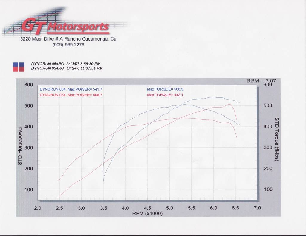

Also the only cam comparison I've seen from some quick searching was a built motor w/ APS TT and Nismo Cam vs. same setup + bigger fuel sys and a GTM turbo cam:
IIRC 14psi in both setups, although the thread doesn't seem to say what stage of turbo cam.
http://g35driver.com/forums/forced-i...g-results.html
