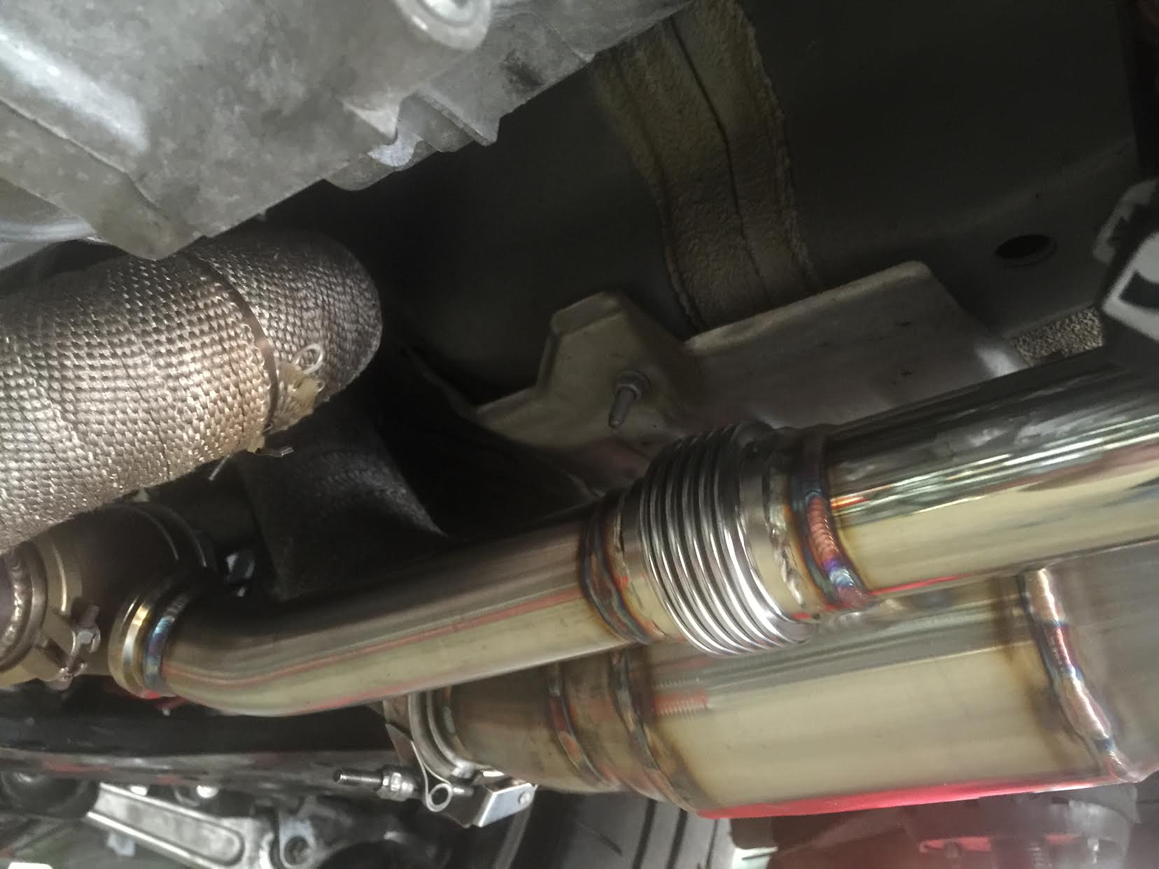

recirculation beauty
Car still needs:
CJM Stage 1 Fuel Return
UpRev GT MAF
