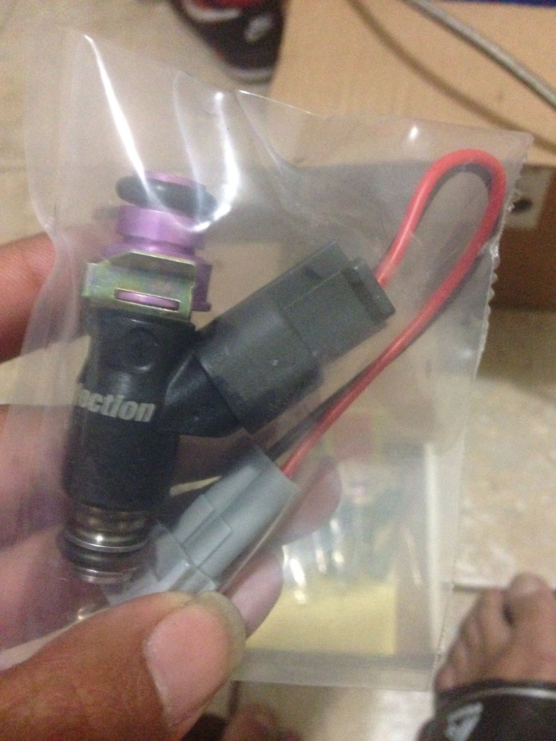

I have 380cc are those good for a non tuned in my g 35 coupe
But I have Kinetix intake the polish one not the plastic one and I have racing aluminum pullyes the kit and headers full exhaust and racing Jdm fuel rail and
Fuel regulator and a bottle of nos single fogger but my questions is....
Is 380cc better than stock

I have these they are 380cc are these better than stock for a non tuned g35 coupe

I have these 380cc .. are these better than stock for a non tuned g35 coupe
