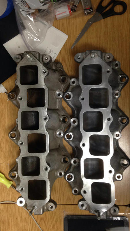

Hey along with the upper ported plenum I found a guy who ports the lower for about half of what z1 charges beautiful work if anyone is interested I can get you in contact with him.

Received the manifold today, put it on in about 30 minutes. Very easy... Porting looks good... Ordered a new gasket with it jic. Driving impressions: car seem to love it! Everywhere! No loss in tq like i was thinking... Much improved midrange and nice bump in top end. So far very worth it. Ill be doing a dyno later today if not tomorrow. My car was bone stock before this mod

I got the car dyno'd and there was no HP gain in the peak numbers,... stayed between 261-264rwhp
This manifold however made a drastic improvement in throttle response and drivability. With some supporting mods this might be beneficial upgrade along with tuning.
