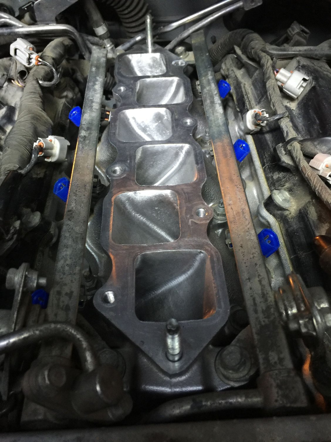

It's fairly straight forward
- Remove engine cover and strut tower
- Remove bolt and un-hook hose in the back of IM
- Un-plug TB harness
- Unscrew TB's
- Remove intake tube to reach in the bottom of the TB's allen key screws
(No need to remove the coolant hose of the TB once detached form the IM & set it aside)
- Remove 8 bolts from the top of the IM
There are 4 bolts that is holding the fuel rail (See photo for the first two, and the other two are near the firewall)
removing the Injector is a little tough so take your time. To install the injector back in, you would need o-ring lube (I used clean engine oil around the o-rings).
You can then pressurize the fuel line by turning the key to on (Not start) and check for leaks.
