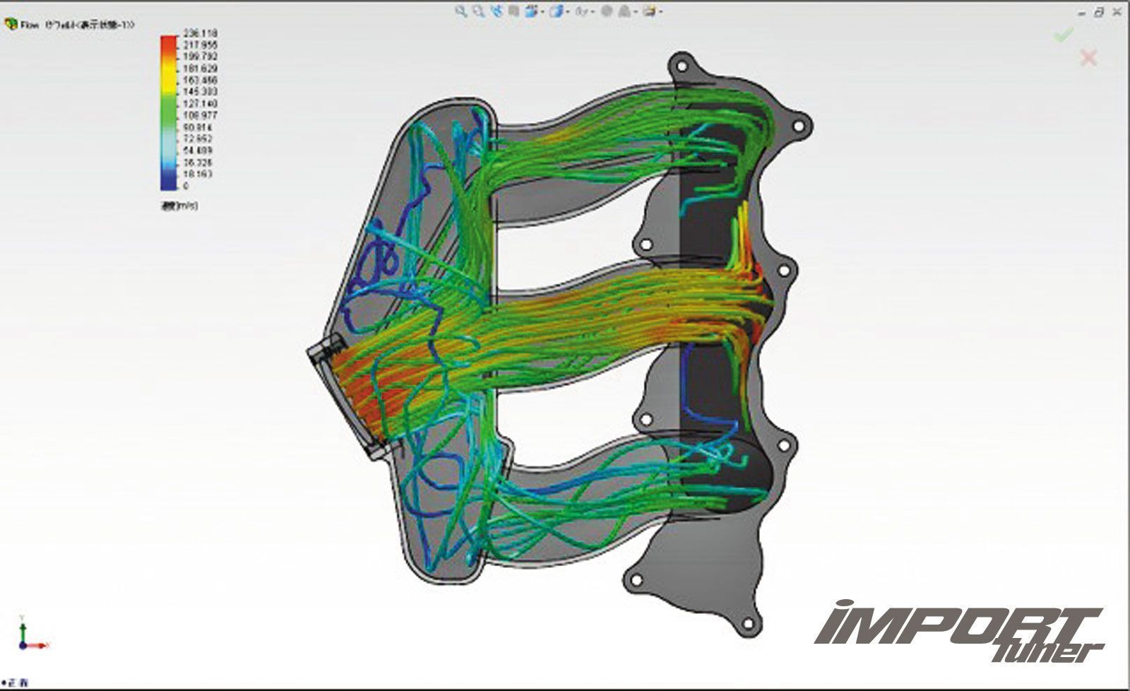

Do you have any idea how even the airflow is threw the gtr manifold? I looks like cylinder 3-4 get the most air with 1-2 getting the least amount.

Originally Posted by John_B
Wow thats super uneven. Any way to improve it?
Yea it is, the only way to improve it is to replace it with an aftermarket GTR manifold. They run around 2600 to 8k for 1.
