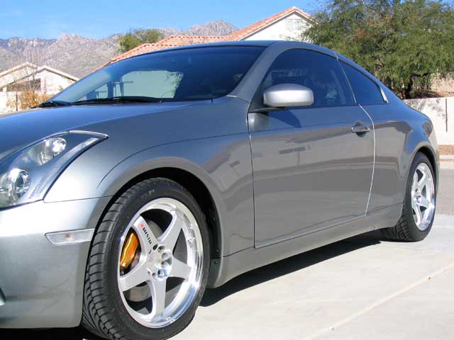

The Nismo wheels are actually manufactured by Rays which also makes the Volk line of wheels (among other brands) and is basically a 5 spoke version of the TE37. They are forged monoblocks and definately lighter than stock, but don't expect a huge difference in acceleration given that you'll be using wider (thus heavier) tires. You may have to go to the track with stock and Nismo rims to determine how much of a performance difference there is. Compared to other rims, the Nismo's are relatively inexpensive. I think they look great.

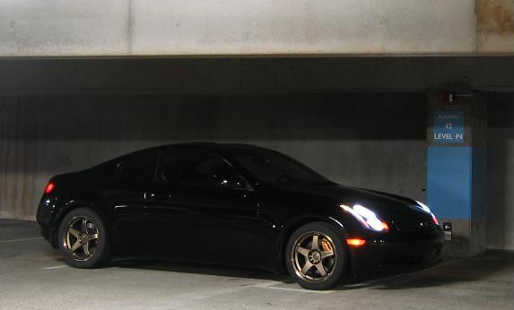

Whay he said
Lou

The pics don't do these things justice...in the looks department, they hold up very nicely to the 19" volks and if you stick with the recommended tire sizes, they fill the wheel wells nicely without a drop.
As far as performance, you can carry more speed in the corners and get a better launch with the wider rubber, but combined wheel/tire weight and more of it further out from the hub will actually net lower hp to the pavement than the stock 17s.
About 6-8 hp. We saw this repeated time and again at a local z club dyno day. You can easily offset this and then some with a crank pulley and breathing mods.
