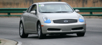

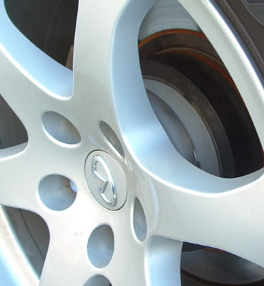

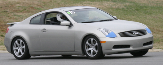

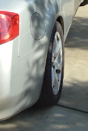

255/45 r17 front
275/40 r17 rear
i also have a 25mm h&r spacers on the rear
Attached Thumbnails Tire Sizes people r using on Track wheels?-virpro-003forg35.jpg   Tire Sizes people r using on Track wheels?-virpro-001forg35.jpg   Tire Sizes people r using on Track wheels?-dscf0037b.jpg   Tire Sizes people r using on Track wheels?-dscf0034.jpg
