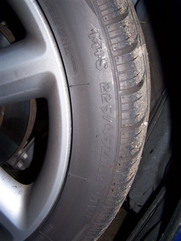

Tire size - I put stock sized Avons on but I think I would have upped the tire size had I thought about it. The Avons have a "rim guard" lip so look much fatter than they are - they don't go into the rim. I've attached a pic since I can't explain it well. I wouldnt go too wide on them.
