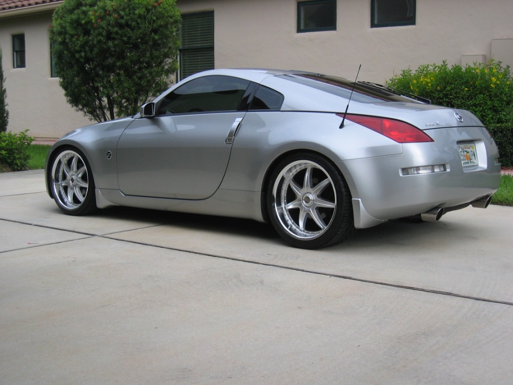

No need to lower with 19's or 20's. I went with 20's and thought it looked fine without lowering but after a week or so "something" didn't look right to me. The car seemed to sit to high and it appeared shorter. An optical illusion I know but it bothered me nonetheless. I then lowered it with TEIN Basic coilovers and it looks much better IMO. Much more aggressive stance and it handles better. Here are some pics; before and after.
Before:

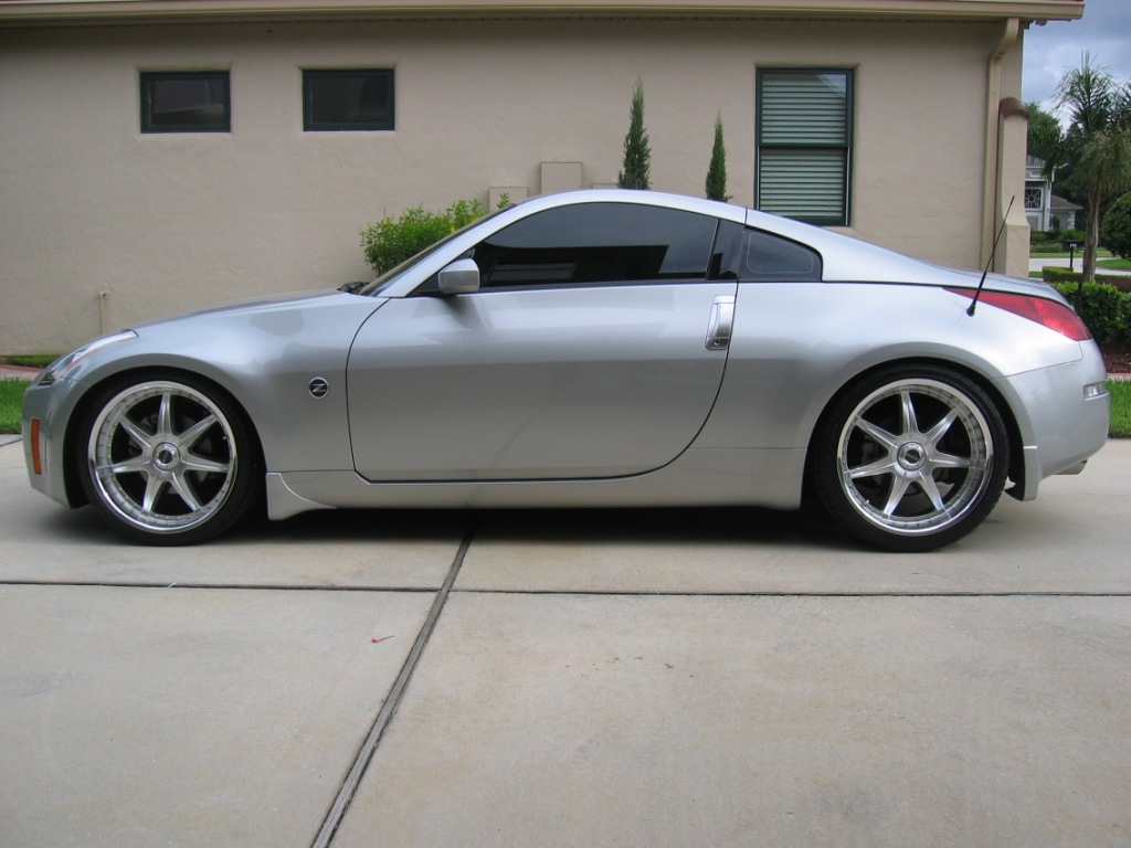

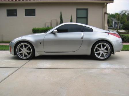

Here is after lowering with the TEINs. Some slight negative camber in the rear but within specs and no need for arms, etc.
After:
Attached Thumbnails Extras after adding 19" rims...-lowered-left-side.jpg   Extras after adding 19" rims...-new-wheels-lowered-left-side.jpg
