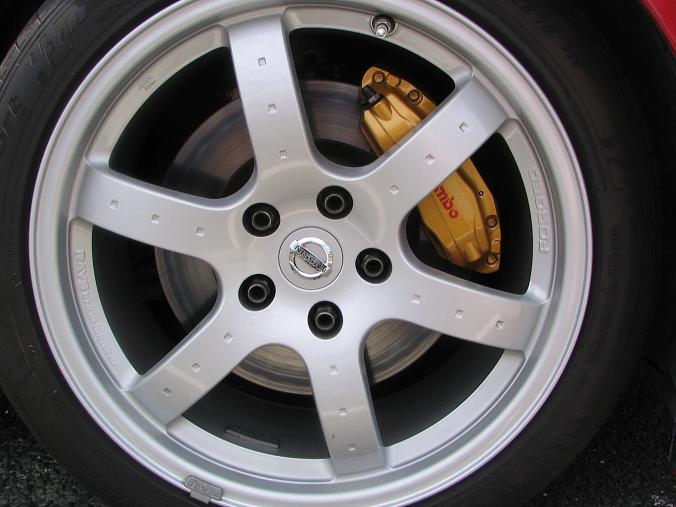

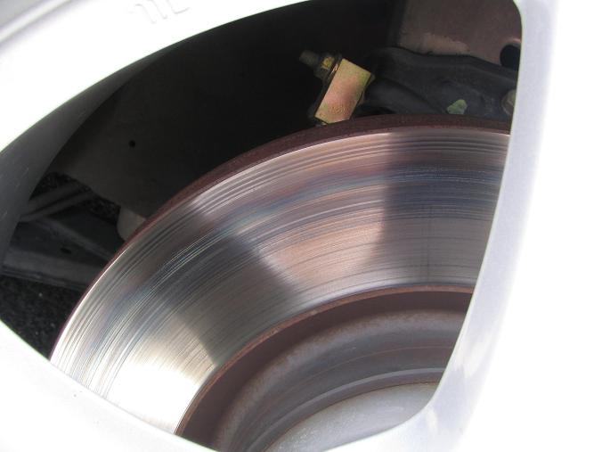

So, I'm out yesterday enjoying a road with very long straight sections in between very tight corners, requiring several back to back to back 120+ to 30 slow-downs. Now, I've seen the metal in my rotors turn blue several times before, but are these waves caused by the ABS's pulses?
And on another note, I need to get a video at night stopping at the end of that road, cause I'm sure I could get the brakes to glow.
Here are two pictures:
Attached Thumbnails what causes these rotor waves?-img_2128a.jpg   what causes these rotor waves?-img_2129b.jpg

I bet if looked at the the rotor, the width of the blueing corresponds to where the vanes are in the rotor. Wider blue sections where there are no vents... my 2¢

Just went out and checked, that's it. Thanks.
