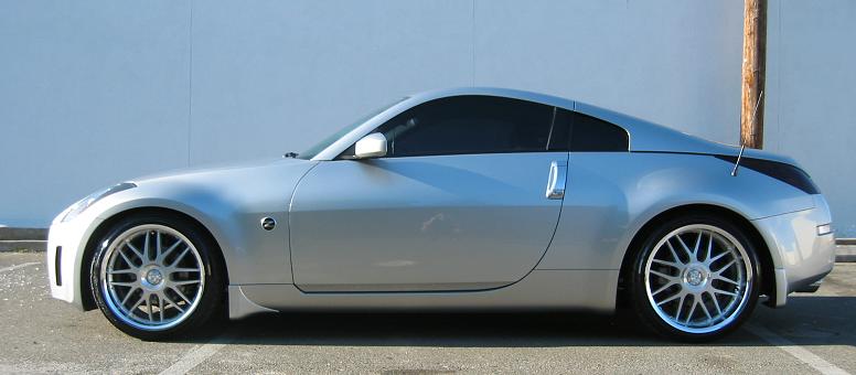

attached is a image of my 275/35/19 toyo ts-1. I dont think they look streched IMO. But I hate how the side wall is taller then the front tires.
Top Sec. runs 245/35/19 F and 275/30/19 Rear on the white Z with the gold TE37s, however I'm not sure the width of the rear rim.
Mr. B has 245/35/20 F and 275/30/19 R on his Z (while at least thats what the Import Racer Artical said).
Basically I'm pretty set on the 30 series in the rear ... but from what you guys are saying I should go with the 285/30/19 insted of the 275/30/19 to not get the streched look correct? Will I still have to roll the fenders with a 285/30/19? Also will the 285/30/19 still give me my desired goal of a not so tall side wall?
By the way thanks for everyones help so far.

you can fit a 285 on a 10.5 wheels easily w/ no fender rolling if you have the right offset wheel

Tire size in the rear and rolling of fenders depends on a few things, 1. wheel offset, 2. wheel width, 3. what type of suspension set-up you have. There is a member on one of the other 350 sites that has TE37 19x10.5 +22 and ran 285/35/19 and Tein S-Tech springs that rubbed so he switched to 285/30/19 and had no problem w/ no fender rolling.

I would recomend a 285/35 on a 10.5" to not have that played out silly stretched look. What are your offsets if they are say +22 like some Volks then with a 285 you will need to roll your fender. Click the pic link in my sig to see pics of a 285/35 on a 10.5" wheel. I dont think it looks tall at all....

Lol M3, you dont look stretched that bad, my 275/30's (BIG mistake) look really stretched, I have 10.5 rear Racing Hart C4's, and also have Tein S-Techs....Looking at my tire and fender, I was thinking about 295/35, but that would probably be too big, and I might have to do some rolling on the fenders, I dont want to do that, so I think I might go with a 285/30 as well....unless you guys think a 295/30 should fit there with no problems??
Lets see some pics of everyones 285/30, 285/35, 295/30, 295/35 rear tire....be sure to note if you had to roll your fenders....
Alberto, your rear tires dont look to tall, but I think a 30 would look a little nicer....but if you dont have a problem, who really cares?
Lets see some pics!!!
