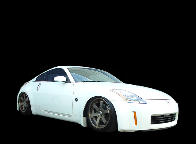

18 x 8.5 F and 18 x 9.5 R but too bad there not TE-37 hhehehe sooon soon to come 19's fo sho
Attached Thumbnails I'm about to purchase either 18x8.5 or 19x8.5 Volk TE37's what offset should I get-williesmalls.jpg
