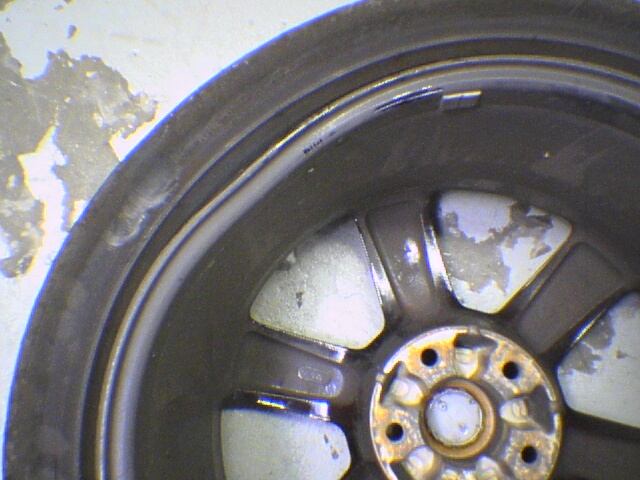

Does this look familure? Chunked the inside of a stock rim a few weeks ago. Many may have bent rims and not know it as they tend to bend on the inside. Ever hit anything hard? Potholes happen. A bend like this will show up as a slight vibration in the steering wheel at freeway speeds. FYI-Repair cost around $200.

Yeah looks real familiar. Best of luck with that. I am taking my wheel off probably sometime next week to get it fixed. It's not really about the money it's just such a PIA to have to deal with this crap.
