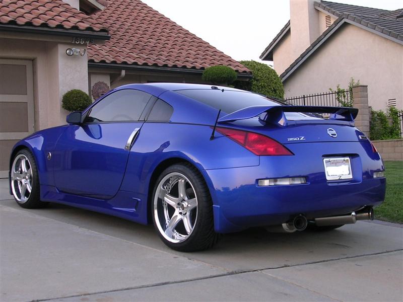

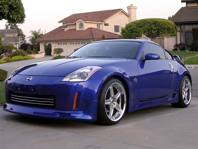

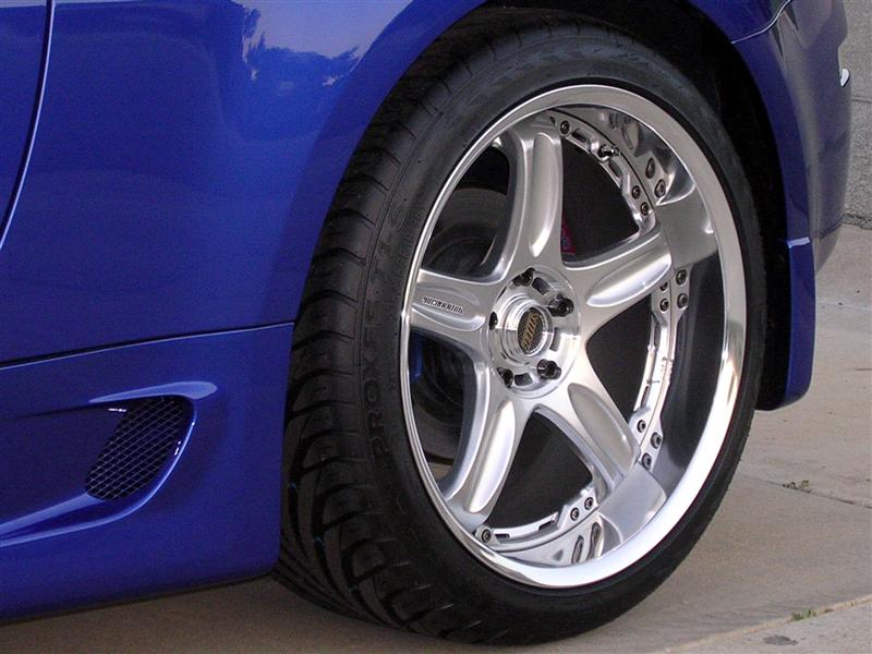

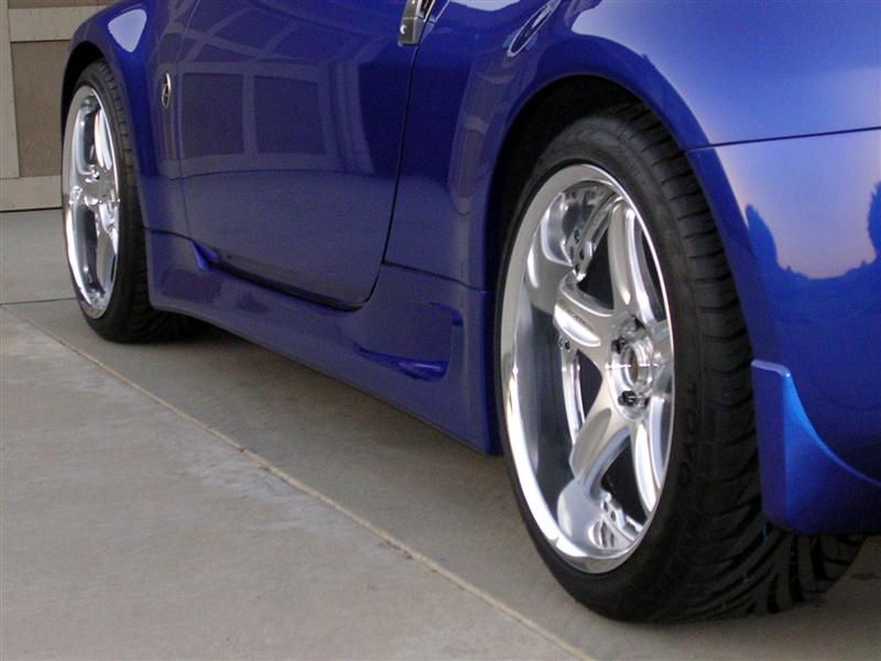

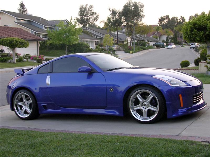

This is what I have:
Front - 19x9.5 Face 1 w/ 21 offset + Toyo T1S 245/35/19
Rear - 19x10.5 Face 2 w/ 24 offset + Toyo T1S 275/35/19
Attached Thumbnails 9.5 front 10.5 rear rims Anyone expert on these???-rscn1145-medium-.jpg   9.5 front 10.5 rear rims Anyone expert on these???-rscn1146-medium-.jpg   9.5 front 10.5 rear rims Anyone expert on these???-rscn1148-medium-.jpg   9.5 front 10.5 rear rims Anyone expert on these???-rscn1149-medium-.jpg   9.5 front 10.5 rear rims Anyone expert on these???-rscn1147-medium-.jpg

^^^^^^ damn you car looks good...

is that a lip kit? What is it looks nice... Geat color...
Old Nov 24, 2005 | 07:08 AM
jlimquest's Avatar
jlimquest
Posts: 717
From: REALTOR Chino Hills, CA
I'm not sure about the lip kit as they came already assembled w/ the tires.
Thanks!
