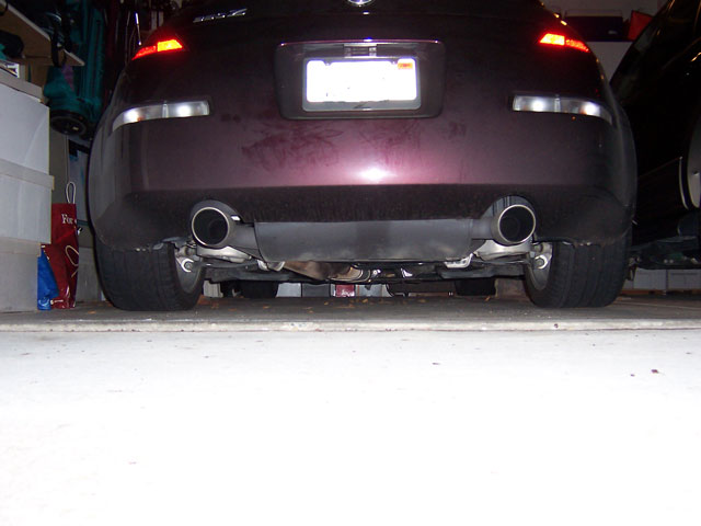

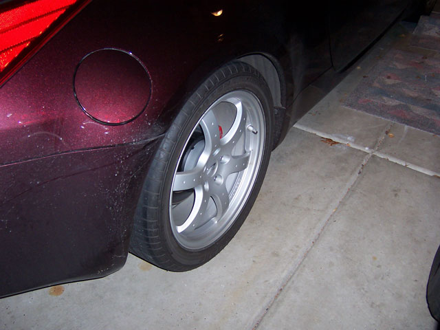

265/40's Rear, 245/40's front. I don't have pic's of the fronts but here are the rears.
No problems at all and much better bite.
