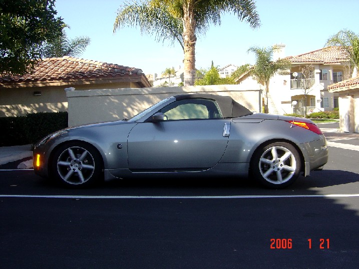

Not Eibach, but here's mine on Espelir GT.

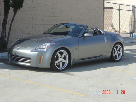

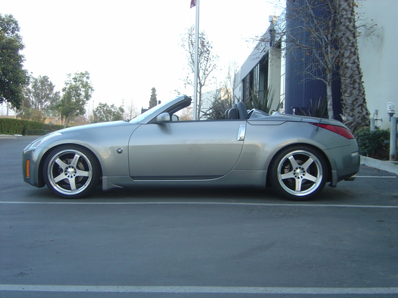

here's my car again, but this time w/ 19's. rear camber is -2.1/-2.2 (max spec is -2.1). front is -1.5/-1.6 (max is -1.3). the alignment shop said that TOE is what actually causes your tire to wear out quickly (can anyone confirmed that?). Toe on my car was perfect so that's cool. Caster was w/in specs also.
if u're NOT worried about spending the extra money on camber kits or tires...lower it cuz it looks and corner better. maybe go w/ coilovers to have some adjustability in case the drop isn't exactly what you want. i hope that helps.
