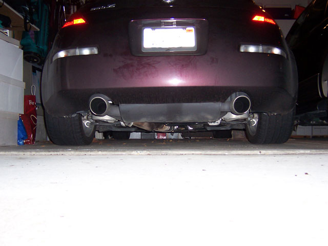

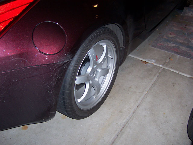

245/40's front, 265/40's rear. Looks mean, better bite and handling.
Sorry, I have no pic's of the front's.
