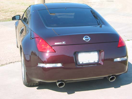

Looking at the car from the *** end hell yeah they look mean. 275s in the back are tight. Very agressive now granted what you are saying as far as getting out side the fender well would be awsome I just think that the amount of rubber you would have to put down would cost you a fortune and the road noise would be emmense not to mention the damage the body might take. Believe me I know what you are looking for and if you can pull it off and be happy with it then you will have quite an accomplishment. Just trying to give some feedback

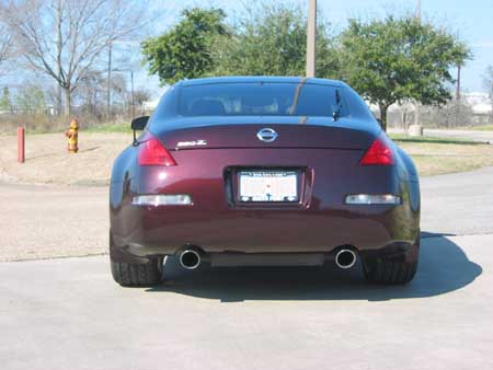

And off the corner

thanks for the info and the shots, it sure is something to think about.

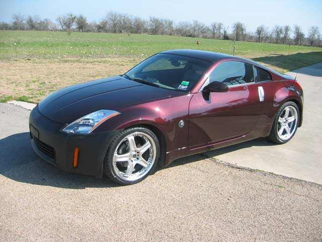

btw, you need to give us a little side shot as well, to see how the car looks with the GT-C

How can I pass on that request?

vova, nice ride.
