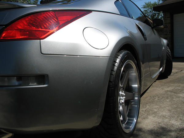

i have the 19x10.5 in the rear(35mm offset). 285/35 tires. no rolling or cutting fenders.
Nice.
