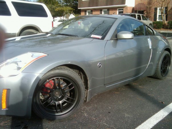

i have +15 offset and it doesnt rub, but im on stock height.

crappy cell phone pics for now

you need to get lowered asap!

i know! :[
shopping for coilovers and BBK now
