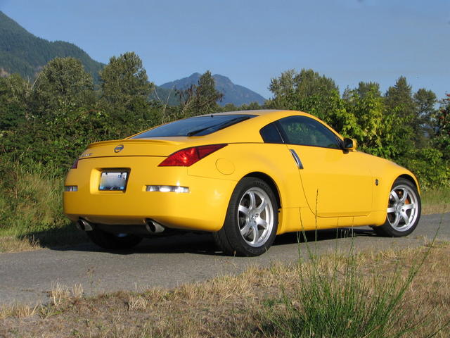

245/40 front, 275/40 rear FTW.
A friend of mine works in the auto industry and has mounted tires for a living in the past. He's looked at the 275 rears and says that they look right. In fact, he thinks that 255 fronts might even be better than the 245s.

anyone have pics of this set up on OEM Rays Track Wheels ???
18x8 - 245/40/18 F
18x8.5 -275/40/18 R

i dont think you could fit a 275/40. maybe a 275/35....if you were brave enough to run a 275 at all.

Here's a pic of mine on the stock track wheels. They look good!
