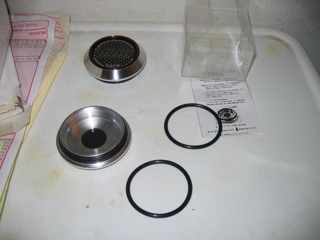

Thanks for the fast reply Brian! Which is the correct O-ring? Here's a photo of exactly what I received in each package of 2 center caps:

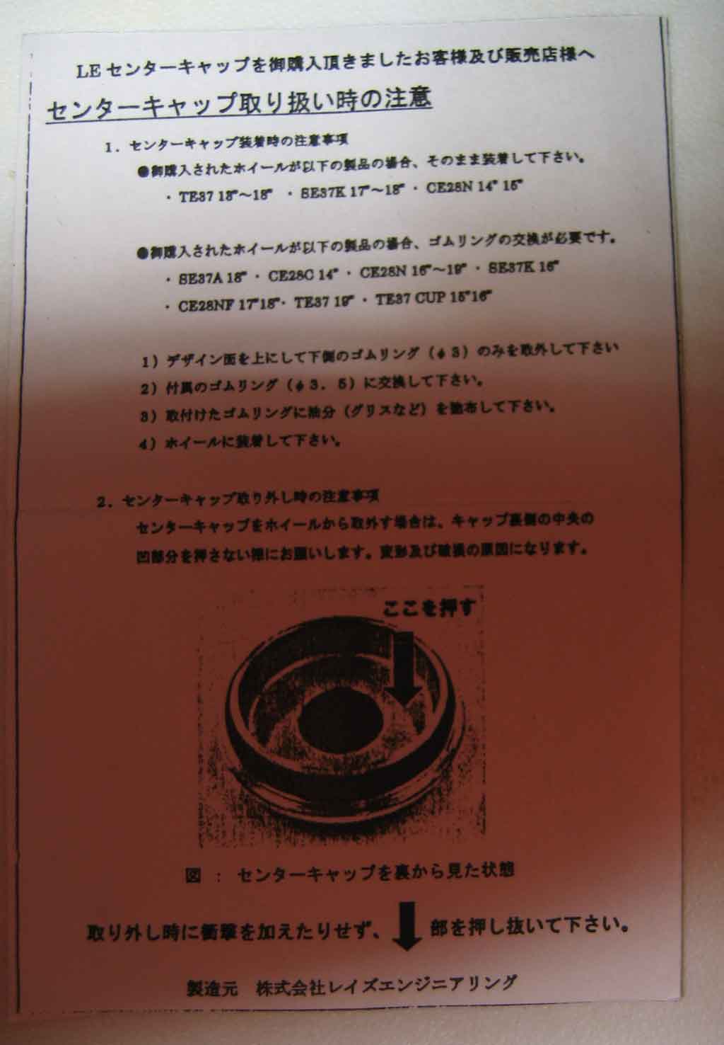

So it looks like they came with 1 extra O-ring per center cap? Or do I need to change out the O-ring for different wheels? The little instruction manual is in Japanese, which I can't read! Here it is, zoomed up:
Can someone translate? thanks!

I just normally use the thicker o ring with im running it on RE or CE wheels

Ok..I just swapped out the O-ring with the thicker ones that came with the center caps. Now it fits in the wheel MUCH better, now it feels secure. Before I could pull the center cap out by just pulling on the front (face) side of the rim... now i have to push fairly hard from the inside to pop it out. Thanks
