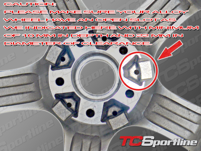

here are some 15mm w studs:
http://cgi.ebay.com/ebaymotors/5x114...9231QQtcZphoto
pay attention to the warning requirement! see pic!
im sure u have to abide by this wih the project kics also.....well only less than 25mm thickness....
from what ive seen it should work on 06 oem z wheels....
-j
