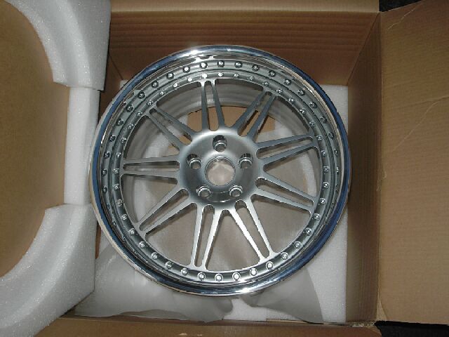

I have
HRE 19" 9.0(front), 10.5(rear)
I called tirerack.com and try to order 4 tires for my new wheels. I was trying to order 245/35 in the front, and 285/30 in the back. The sales person would not take my orders. What!!! I was so shock. The sales person said that 350Z is not design to fit lower porfile tires in the back. What is the right size then.... Should I order 245/35 in the front, and 285/35?
Thanks guys and have a nice day.

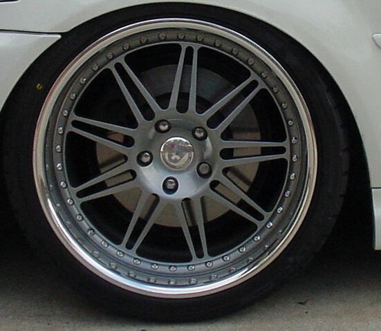

Default Thanks again "toothlessracer"
I just got them today. Charcoal paint Finish. by the way you are taking about 19" right? just making sure! ^^ 255/35 Wow! that's big! When you are making turn, does it touch inside? from what i heard it touches inside... What kind of tire company do you use? may be"Continental ContiSport Contact 2"

I am using 255/35 and 285/35 on the same size HRE rims you have and it drives AWSOME. Nothing rubs, nothing touches, no fender rolling. Drives like a dream. I also have about 1.5" to lower in the back and about an 1" to lower in the front which is getting done Wednesday with JIC FLT A-2 coilovers.
These sizes are the closest to the stock diameter. They are closer than the 245/35 and 275/35 combo a lot of people are using. The only reason a lot of people here are using the 245/35 & 275/35 is because most people on this board are Bridgestone fanatics and Bridgestone doesn't make the correct size so that is the closest they can get.
I bought the tires at Tirerack no problem. Just order them online and forget those stupid sales people. That is what I did.
