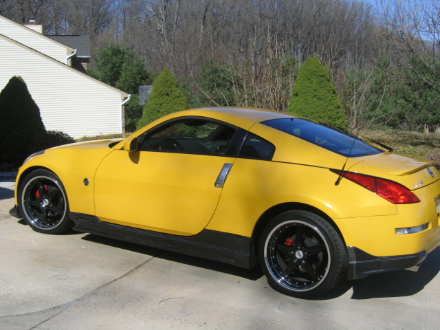

i thru in a photo of the attention getter!
