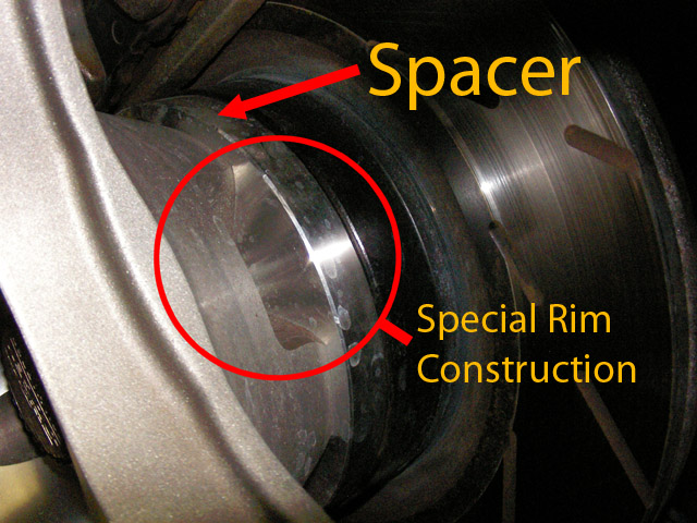

If you go with stock rims, unless the spacer is +20mm to hide the nuts, you'll have to knock out the old bolts and insert new bolts.
However, the bolts shown will not suffice for a bolt replacement. They are not the right type. They need to have little ridges around them and no taper.
If you are attaching a 15mm spacer with its own bolts to stock bolts, then you need a rim that actually is built to allow for the bolts to co-exist. See in the picture how my rims have a space for a bolt?
I just did this job, and I went with 15mm spacers and replaced the bolts. I didn't like the unclean finish and I also feel that the spacer/bolt method puts too much stress on the bearings.
