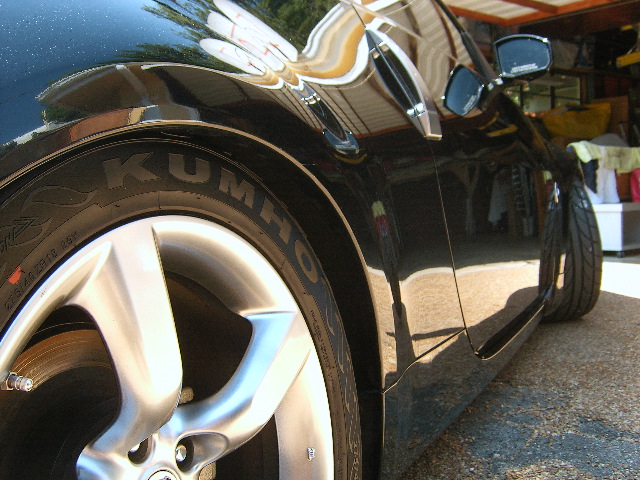

^you'll be fine with 275/40 rear and 245/40 front, they meet oem spec more or less.
here's how my 275/40/18 rear looksKumho Tires-general-tire.jpg

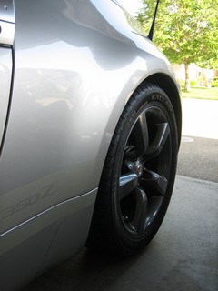

245/40/18
275/40/18
Kumho Ecsta MX
