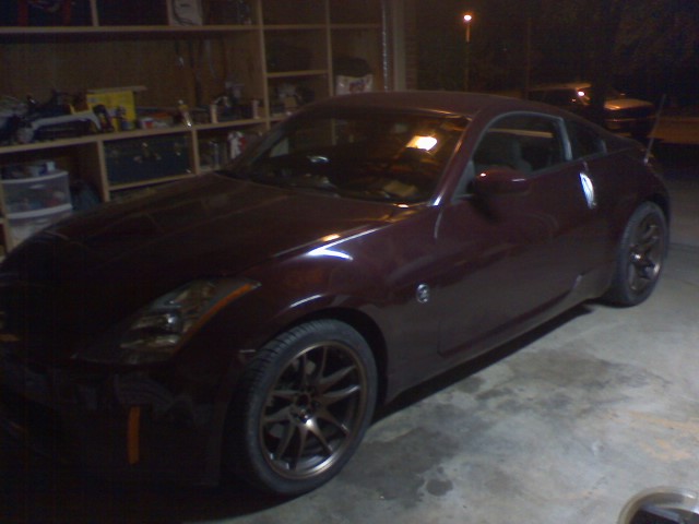

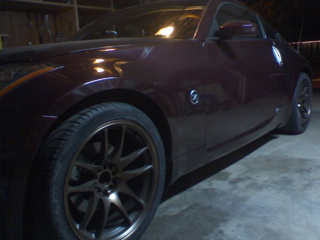

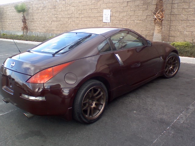

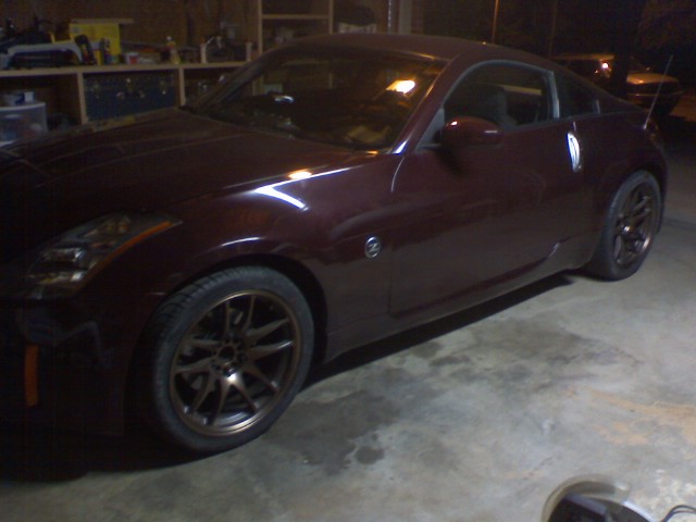

Im running 18x9.5 all around with 265F tires 275R tires

Well I havent driven it that hard yet in the corners to be honest ... I still want to upgrade the suspension first before I really push the limits. As far as daily driving goes and reg. speed cornering they are VERY SOLID and give driving a solid feel as well, personally I like having the wider wheels and tires in the front it gives that bulldog stance to the car...
