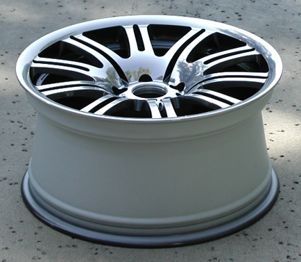

is there a way, or a rim that looks close to this, that will work with the z's bolt pattern??
honestly NOTHING out there as far as rims are doing it for my with the z...it would be sweet if these would work.

if the offset allows you could get wheel adapters.

huh...sweet, you would think the offsets would be very similar?? how would i find out what they are on either car?

what I mean by offsets allowing the use of adapters means, the wheels would have to be about 45mm offset assuming they were about 8.5" wide... that would allow the use of an adapter which will run about 25mm thick. Basically the adapter will act as a spacer.
Understand?

give specs on the wheel, you just need 114mm lugnut pattern and itll work fine, bolt right on. theres a chance BMW uses that size...

iirc, BMW uses 120mm (their own size)
btw, don't put m3 wheels on a Z, maybe something similar, BUT NOT the exact wheel
