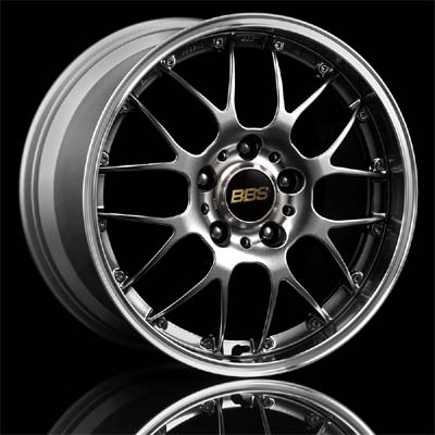

Recently, I bought a set of 18x8 +38 offset BBS RSGT for my G from ebay. THe shipment will be here by Thursday. Wondering whether or not I need to grap some spacers. Please give some advices.

if you have a coupe, those are horrible offsets. you'll be like 1/4" more tucked than your stock wheels. you'll need like 30mm spacers.
if for a sedan, it might be ok.

Yeah, if your G is a sedan than probably will look okay. Coupe, then you will probably need a 25mm or 30mm spacer.

mine is a coupe......

yes, spacer

Nice wheels. Put them on the car and see if you clear the brake calliper and strut housing. Go from there.

I have wheels with offsets like that. Run about 10mm more spacer in the rear.

Those offsets are horrible. Worse than stock and narrower than my rear stock rims...
I honestly suggest you do at least 15mm spacers, even then it will look weird due to such narrow wheels.

going to need BIG spacers on those...20 to 30mm

then just buy some 30mm spacer and you'll be happy!
