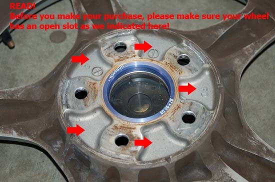

cHECK the wheels you will be using with the spacers. See if they have "ROOM" between the bolt lug holes....
if there is room it will work...

HERE is a pic of the back of a wheel!
All you need is a "slot" or gap between the lug holes so that the original OEM lug does not make contact with the wheel you are using.
check the back of your wheel and get back to us. or take a pic and post it.

NO!!! Stock bolts WILL stick out past the front face of the spacers...this is why you need the 'SLOT' above on your wheels. whichever ones you choose to use.
on the Z with stock lug bolts anything less than a 25mm spacer will not sit flush and your wheels will have to have this slot in order for the wheels to mount up WITH OUT the oem lug bolts making contact.

Check your wheels, I know my Work Meisters did not have the slots.

JLine and Maya wheels also do not have those gaps. SSR and Volks do.
