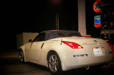

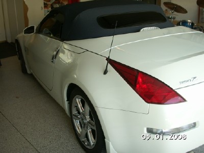

thanks for the advice guys...
I purchased the tires last week...
Nitto NT 555 Extreme Performance
fronts > 245.45.18"s
Rears > 255.45.18"s
they look great on the Z..... Now it's time to deal with the camber issues...
The Eibach Factory in Irvine is about 5 miles from me....
from what I've read, the Camber/Toe alignment kit is what i need,
I was curious what you guys think of air ride suspension on the Z?
here's a question for one of you.... can I use shorter springs with an air ride?
or does the air suspension not use springs?
my tires have some beef to them, so The ride is smooth so far, you and I know once i drop this beast, I'm going to feel every little bump, and that means the ole lady is gonna give me an earful.....
she likes the stock feel, and I like it slammed!!!
I appreciate the feedback...
I'll send some pics in the next post....
