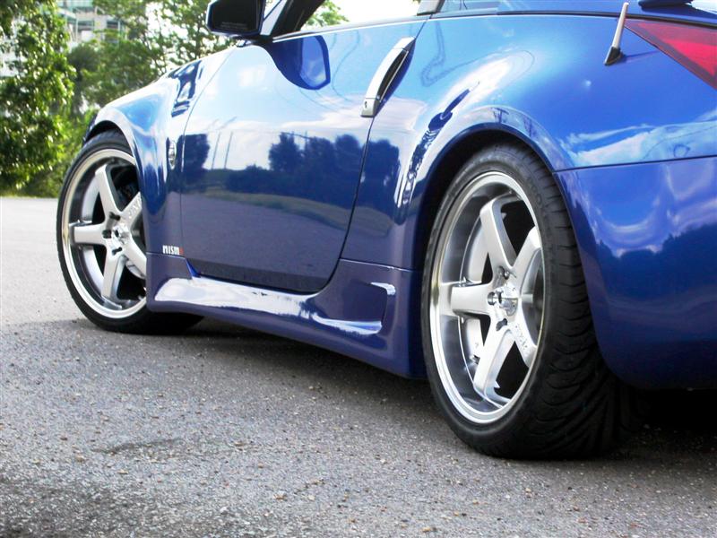

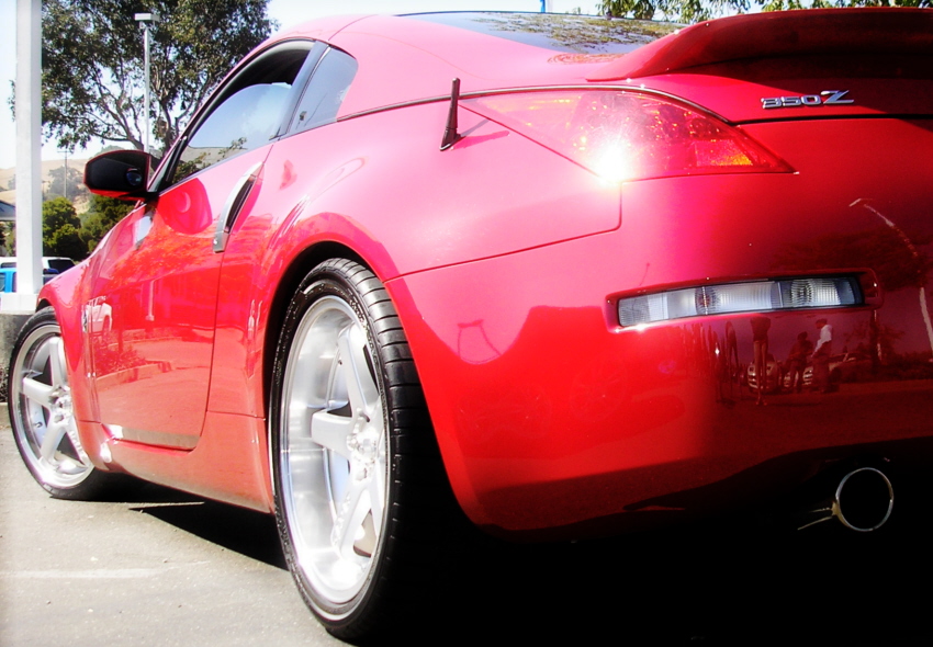

Hi Guys, I don't think I can justify getting Volks and I saw these and thought they look great. I have done some research and got some advice but I just wanted to check before I order something.
I am getting 19's. So far I am thinking of 8.5's with 245's and 9.5's with 275's.
I thought of getting the 10.5 with 285's but I was told if I am staying NA it is not worth the extra weight and should stay with 9.5 rears. Does that sound right?
What offset is ideal? Do Axis make different offsets for the 350Z or just the one that suits the car. I want this look. I think it is +20?
Hear from you all soon!

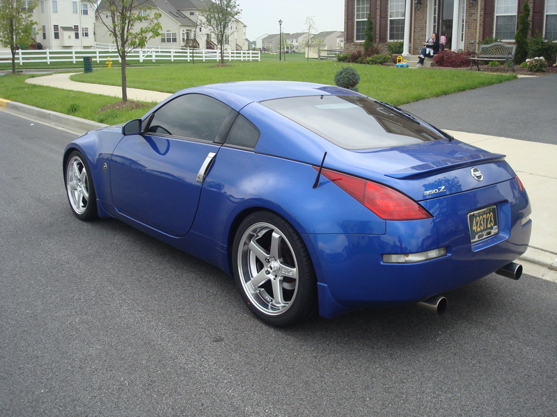

Yes duplicate this.... Hiro's, with no spacers. This is the last time I'm posting these pics cuz I'm sick of looking at them, even though it's my Z.

The rears are 10.5 with a 35 offset.
The 9.5" rears they sell for the Z are 25 offset which means the outer edge of the 9.5" rim will be 3mm more tucked in than my pic.
Plus on the 9.5" your lip will be about an inch smaller.
I had the 9.5's on the rear with 275/35's originally but I really wanted to go with the 10.5 with 305, so I sucked it up bought 2 more wheels and tires.
If you want to run wide tires with tons of all around grip, the Asian owner guy at Axis (can't remember his name off hand) recommends 9.5" fronts with 265's and 10.5" rears with 295's.
That would be my next choice of setups, But when I started adding up the cost of all that rubber I wussed out back then and went with 8.5 and 9.5, then later wished I would have sucked it up the first time LOL

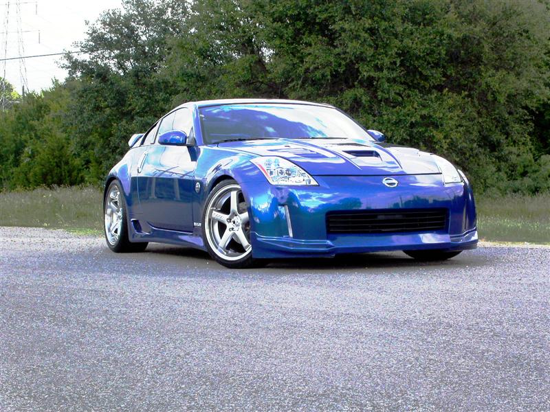

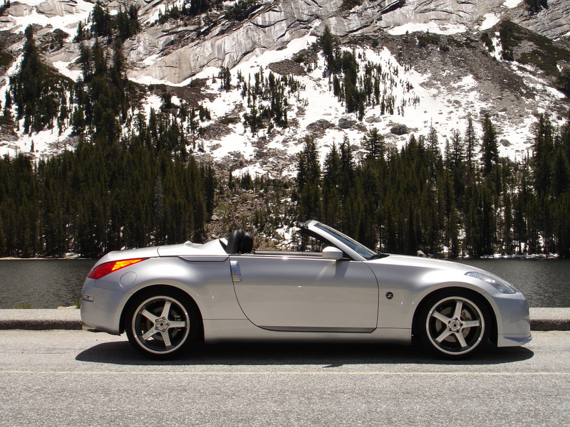

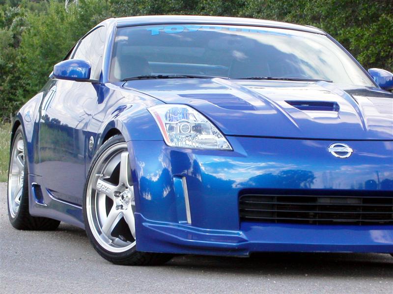

Ok found the Daytona pics I was looking for. Car belongs to a member on this site. It's the same car pictured on the right of the Op's first post.
They are 8.5 front and 9.5 rear.
