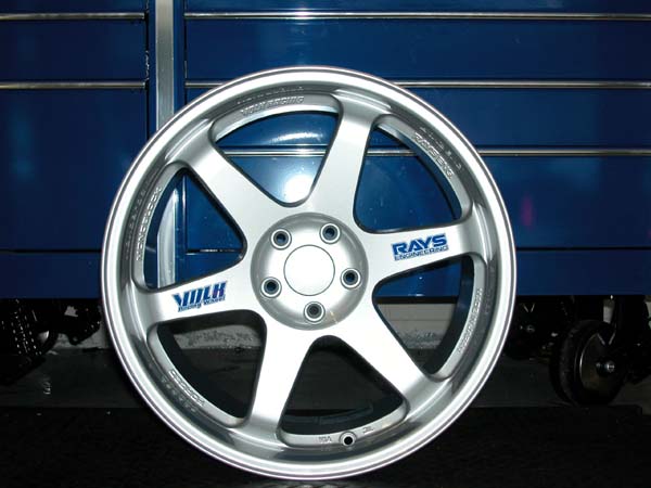

Ok..here's a sad tale. A while back I bought a set of Volks TE 37's in silver... (from a guy here)
real nice looking...19" 8.5 front...9.5" rear...with a great deep lip because they had a 12mm offset.
looked KILLER, did that lip..the fellow assured me they would fit no problem..so me being an IDIOT. bought them.
today i take the car apart, put on my nice new JICs...front rims...oh man it's looking great...back rims..hmm...seems a little tight.
yep. they dont fit. they stick out too far. even with the Jics cranked all the way up.

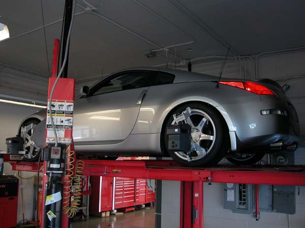

almost..but not quite

the villain:

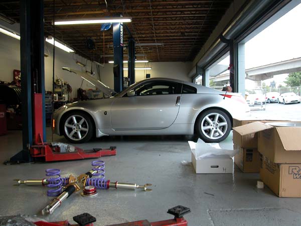

the Jics are nice

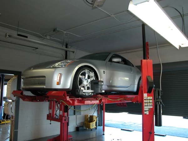

sigh...what a frustrating day.

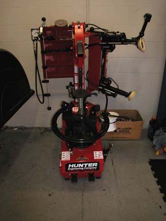

on a lighter note..for any of you in the Bay Area, my friend Randys over at
El Cerrito Mitsubishi just got this Hunter specifically to mount over-sized rims.
They plan on opening a full on Tuner shop and will happily work on your Z.
as you can see in the pix they have a top notch set up.

nice machine...

thats a seriously agressive offset, with a lowered car, it was definitly a forseeable problem.
rolling the fenders isnt that big of a deal, if you dont mind spending the cash.

the Jics went on smooth as silk, On the rear wheels i ended up with a gap of only about 15 mm between the top of tire and the fender and the outside of the tire was flush with the outside of the wheel well.
for one brief insane moment I considered adding 'helper springs' to RAISE the back of the car another 65mm..but not only would that look stupid, the tires would still have rubbed.

the rid is awesome. I also installedd the swaybars....we measured the car stock, then eyeballed the jics...tput them on...hey where WAY off...so then we used the alignement machine to dial them in. I would say theres no way to dial them in 'by hand' I would definately recommend you do it at a shop. once in no squeek or rattle, a couple of 'settling' creaks was it. The ride is not drastically stiffer...it is still comfy....but a lot, lot 'tighter'. Then again..It is the 'street' springs and not the 'race' springs. i am very happy with this suspension.
one thing tho..the straps for the brake lines/speed sensors are hokey..I am going to get some clamps made.
JIC also should include instructions/spec sheet. there where NONE in the box.
