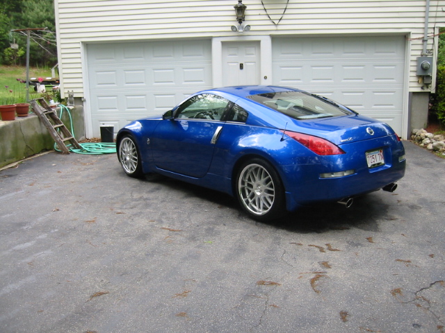

I went with 19x10 in the rear with 275/35/19. I didn't know racing hart made a 19x10.5 I would of gone that way. Will 285/30/19 be o.k because i'm almost dew for rear tires.

I have 19's x 11 rear OZ Superleggera III. I also have 295x35x19 Michelin tires. I have no problems whatsoever with tires rubbing. I don't understand why people have to roll fenders with a 10.5" rear. Now, it makes me wonder if my rims are really 11' wide.

Denic79,
Nice wheels! You might have to roll the fenders if you go with 285 depends on your offset (what is your offset, BTW?) and brand of the tires. Some tires are wider than the others eventhough they're all same spec.
