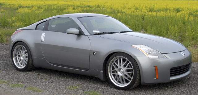

I used to run one of the performance shop here in the Bay Area and got to learn how to roll the fender. It's pretty easy, takes about 30 mins to roll 2 rear fenders. If you want to get your fender rolled, make sure that the place have a fender rolling tools, not just a baseball bat or pipe. You also have to heat the fender with the heatgun to soften the paint so it doesn't crack.
The reason that I bought 10.5" with offset 22 and 295 tires is because I like the lip (almost 4") plus I like the fact that 295 is the widest tires you can put on a Z.
Check out the pictures below for now. I'll take some close up of the fender whan I get a chance.

Huh, those do look cool. I have had no problems out of mine, I went from 17s to 19s. The ride difference is actually not noticable to me. But what is noticeable is when I hit a turn. Woha, what a great difference.

me too karma...but i didnt like the idea of rolling the fender..so i solved my problem by getting 10" wide iforged aeros with a 4" lip...i can fit 285 on the rear according to vic350z...295 might rub on the inside so its not worth it..cant wait to get my wheels ..ill post pics when i do...i thought that your rolled fenders would look different than they do....the image i had in my head of rolled fenders doesnt look like the one you posted...yours looks real nice and clean...but i dont see a difference between the rears and the fronts..please post close ups
