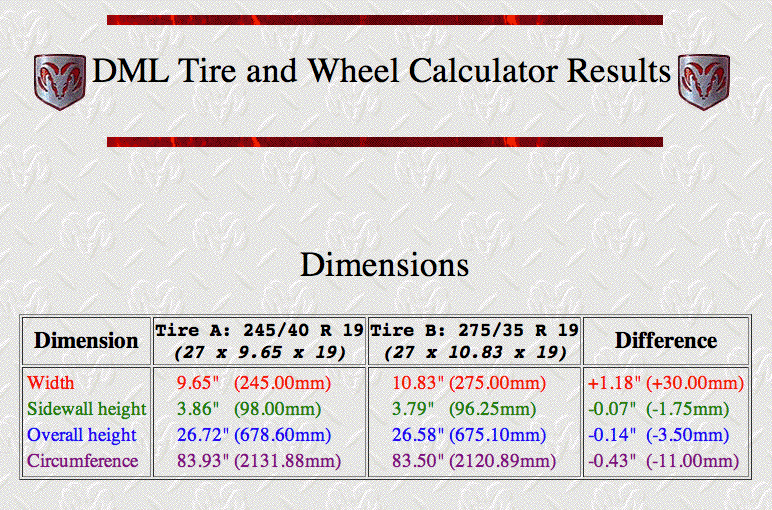

hi guys, i'm about to get the ENKEI GTC01 19" rims.
what are the recommended offset for those rims?
i'm getting F19x8.5 R19x9.5 so 245/40 and 275/35.
what do you guys recommend on them? what i am getting is +22 front and back.
do any of you guys know how MCR use on their car?
thanks in advance.

BTW the front tires are taller than the rear.

The 8.5/9.5 +22 combo is pretty flush. You can run 255/35/19 front and 275/35/19 rear. The 245/40/19 front you proposed would be 1/8" taller than the rear. Not sure if you'll like that or not.
Here are the same dimensions/offset (19x8.5+22 front/19x9.5+22 rear) with 255/275.
