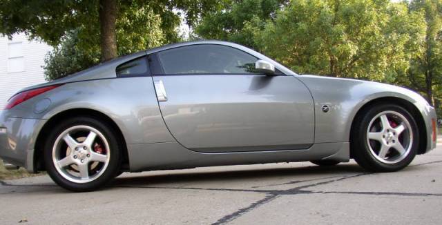

I had to get new lug nuts for my Borbet wheels. They were originally on my Dodge Stealth and the original lug nuts were 12mm X 150. The 350Z requires 12 mm x 125. The stock lug nuts would not work with the Borbets. If you buy wheels the lug nuts are normally purchased with the wheels. A picture of my 350Z with the wheels from my Stealth is attached.
Les
Attached Thumbnails all aftermarket wheels need new/different lug nuts?-passenger-side-low-smaller.1.jpg
