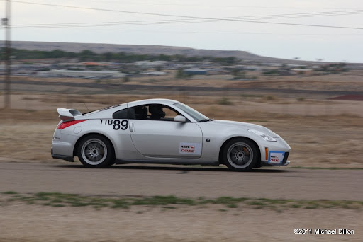

for haters.. nismo on 17" enkei rpf1

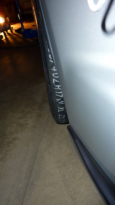

Just added a square RPF1 17x9.5 +18 setup, running 255/40/17 Hankook RS3s. This is on a stock Nismo OEM suspension except SPL front upper arms. Tons of room in the back.
I put in a 5mm spacer (+13 effectively) and there was still a lot of room for tire or additional offset.
Still the ugly wheel gap without a drop, but this is a track setup...
There are no clearance issues on the front even at an estimated -0.8 camber, at least for a 255 wide tire. It's getting close though so have to do some testing on 265-295 to see if still clears the fender. Ataru is running 275s, but aggressive camber might be needed to clear. Here's some shots of suspension fully compressed w/ the 255 and running an estimated -0.8 camber (i.e. SPL arm w/ all three shims)...
