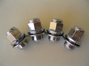

looking for lug nuts now...any suggestions where to get or reference would be appreciated. Are these the OEM lugs nuts that 19" Rays wheels use?? (see attached)...because i see a lot of the aftermarket that say fits Rays or 370z and etc...but they do not look the same, no washer there....all are acorn

yes those are the factory lugs that you have to use... I will keep my eye out for some

FYI.... For those looking for the 370z lug nuts w/washers.....
factory 370z Lug Nut: Dorman PN# 611294
Type: Dometop Capped Nut
Thread M12-1.25
Hex Size: 21mm
Length: 38.6mm
Seat Angle: 60 Degree
Finish: Stainless
These are the OEM Lug Nuts w/washers
Here is a website that I found that sales the lugs rockauto.com and here is the Item brand and # for the lugs. DORMAN Part # 611294 they are $3.49 earch and from Jegs.com they are $52.99 for all of them, just copy and past the part number "611-294" in the search.
Link to jegs: http://www.jegs.com/i/Dorman+Product...1-294/10002/-1
link to rockauto.com: http://www.rockauto.com/catalog/raframecatalog.php click on wheel/tire then on lug nut and scroll down a few to the one with part# 611294 and there you go.
