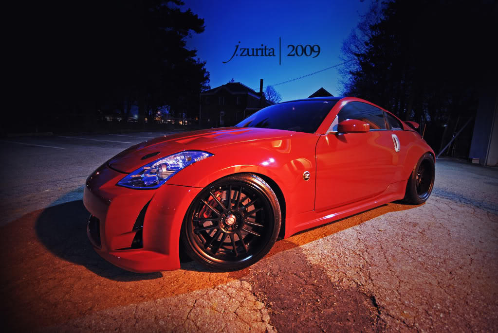

That's the point of the thread,
I still think the OP of this thread has the best setup in the thread and he's running a 295 on a 10.5.....

Yea but its the smalllllest recommended size. You could go up to 295, even 305.
With that being said though, I love it! Reminds me of Kevin Pierce' G35.

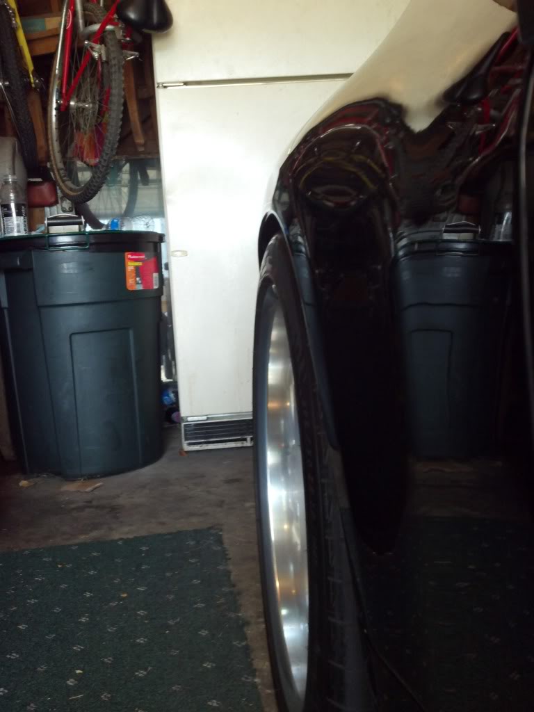

Dug up a picture for you, 19x10.5 +22 with 275/35-19 in the front at -2.3 camber.

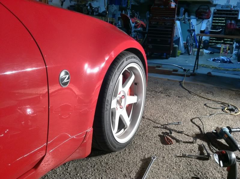

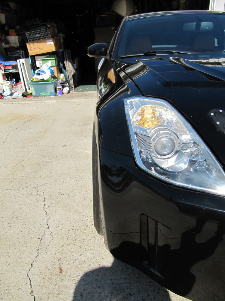

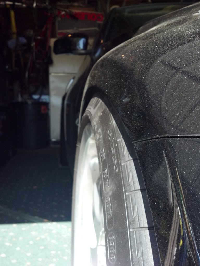

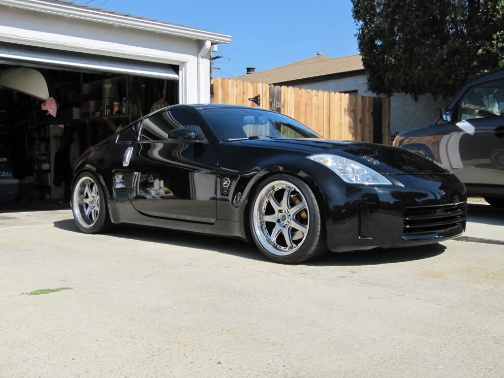

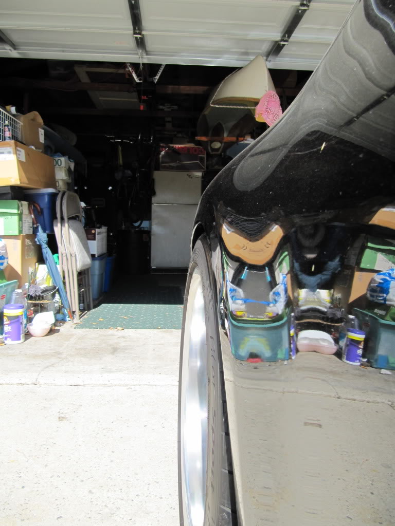

I need some help to roll with the best here. Im sorry to ask, but I need help with deciding which spacer to run. I'm either going to run a 10mm or a 15mm on the back. The front has 20mm.
Here's the kicker, I do not know exactly what offset the wheels are. I put the 20mm on the front and it is EXACTLY what I was hoping for.
Known wheel specs:
19x9.5 front with 255/35/19 Michelin PS2
19x10.5 rear with 295/30/19 Michelin PS2
Volk GT-7 (the offsets allowed them to fit my OEM Brembos before the spacer, but It was not aggressive enough for my taste, hence why I added spacers)
I bought the 20mm spacers because it was a good deal. They were too big for the rear. I have stock camber settings in the rear. I am dropped on Eibach Sportlines.
My question is, can I run a 15mm spacer in the rear and not have to run a lot of negative camber, or would I be better off with a 10mm. My car is daily driven unless it's a nice day and I decide to ride my bicycle.
All of you're help is very much appreciated, thank you. now on to the pictures

^That looks beefy!

thats a dusty *** car

it was in the garage and hadn't been driven since i detailed it, but today when i was taking the pictures, the garage door was crachked and the fcking gardeners blew all the dead dry grass and dirt into the garage
Does anyone have an answer to my question?

if you want to run a 15mm spacer and not have neg camber get narrower tires

Not down sizing. I think I am going to go with the 10mm. I honestly wouldn't mind getting a little more negative camber though. I'm not sure. I'm thinking about this way too much and being too indecisive.

Okashi i don't know if you've done it yet but just roll em alot ( It'll prolly get to the point where you are pulling it also) and you'll be just fine. I'm alot lower than you running 295 30 19's in the rear and I'm at -1.7 rear camber. I'm slapping on 15 mil spacers next week soona s I have time to roll it more. You'll be fine.

They're rolled flat but not pulled. I can get them pulled for free from the guy that did it here in Long Beach. He pulled the front fenders out a little already.

I don't recommend spacers if your not going to lower it....
It's gonna be mexi-flush...I say just lower a tad and it's golden...

You can run whatever size spacer you want, then just adjust camber to get the tires where you want them. The setup you are running now looks good, add a spacer and you will just be adding negative camber.
