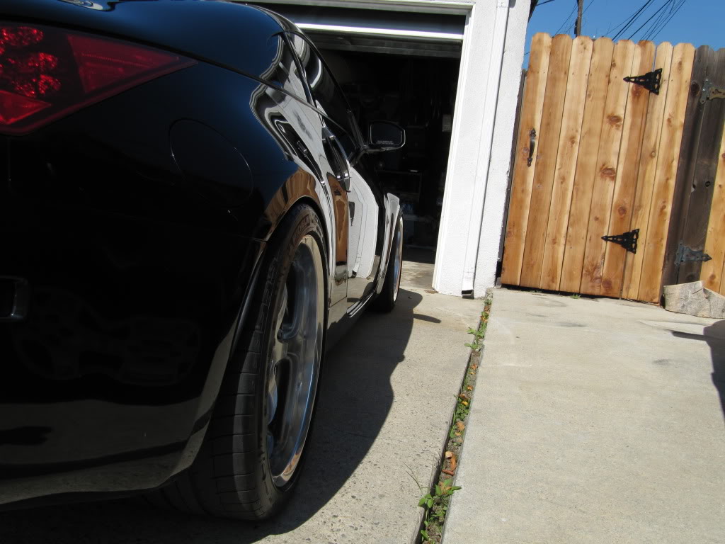

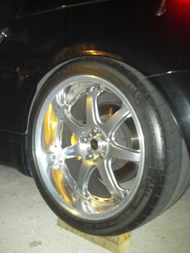

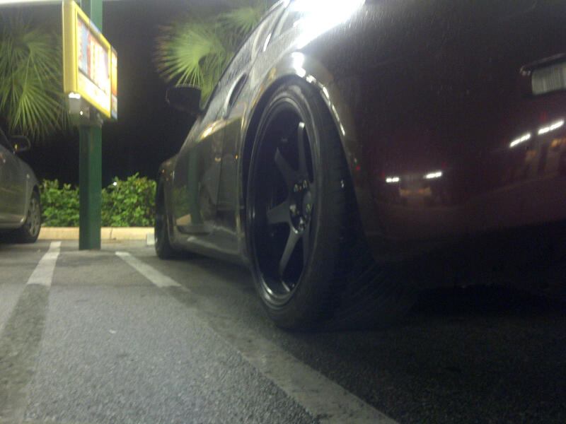

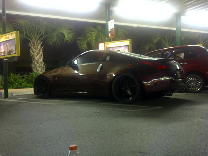

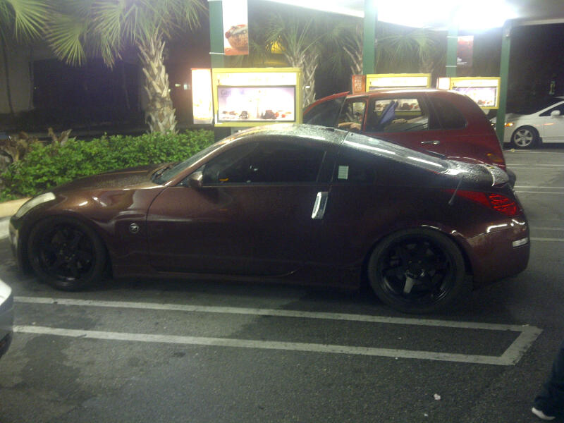

KingBaby Speaks ze truth. Moar low. Moar awesome.
Speakin of sorry for those of ya'll that i told i would get up pics of a 295 35 and 275 35. Had em mounted. Sidewall ruptured on my wheels. wasted the tires. Gonna wait till the weather gets better for pics. But it's mighty awesome. I tuck 295's right now. Rear fender to ground height is 24 1/2 in and so is front. Rear camber is at -1.7 for both. so pretty much oem.
I'll get legit pics up in a week.
But shitty Cell phone teasers in the meantime?
19x9.5 +22 (255 35 19) F
19x10.5 +22 (295 30 19)R

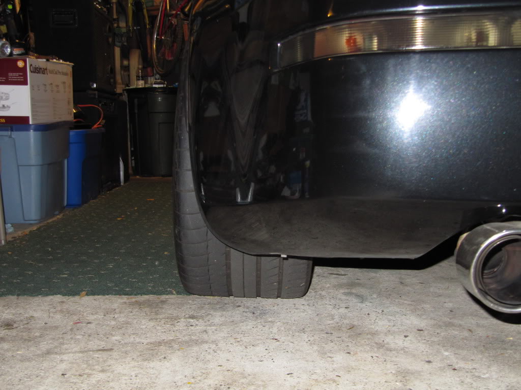

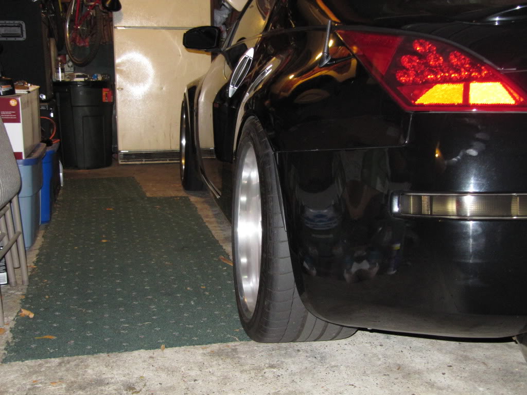

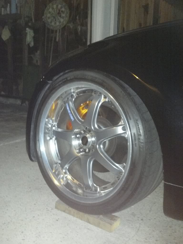

I had the extended studs installed tonight by a local shop and put on a 10mm spacer. I'm going in for an alignment on Monday. Its on Eibach Sportlines, only way I can go lower is if I cut the spring mount or go with coilovers (which I would be very happy to do, but I dont spend that kind of money on myself during the holiday season). I think I will go ahead and cut the springmount sometime this weekend if I get a chance.

Thank you. Im going to do the spring mount mod later this week because it seems more noticeable that the back is higher than the front now. The back wheels look like they are either perfectly even with the front or just barely out further, but there is a gap over the tire in the back and there isn't in the front

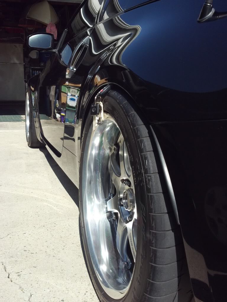

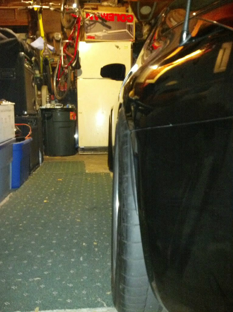

Feedback is very much appreciated, I'm always in need of constructive criticism.
The remote won't fit in the gap in the front tire.
And it does in this gap. I want to close that gap however much i can.

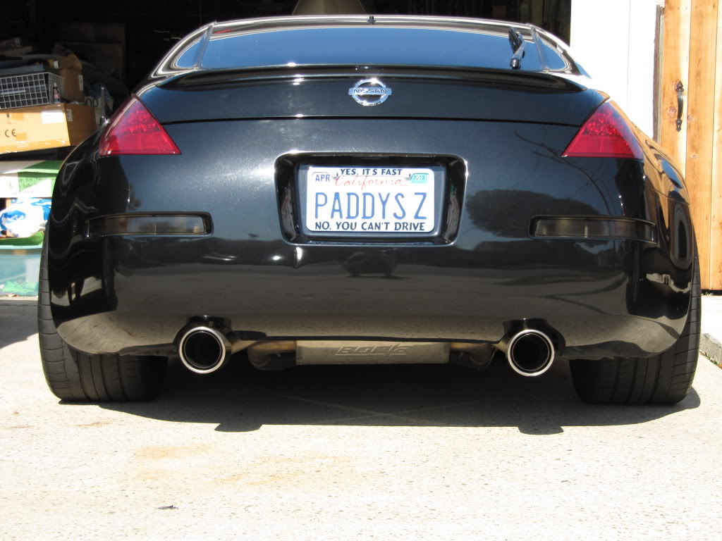

Shots to show fitment

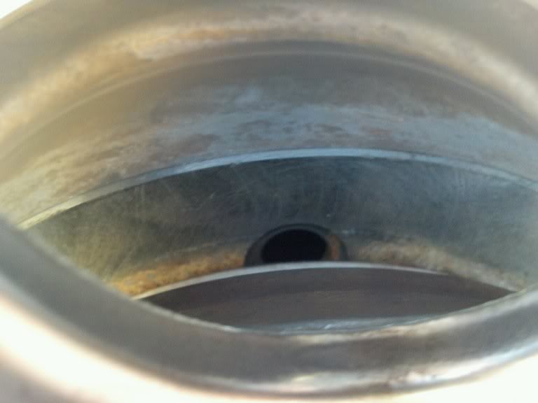

Also, what is missing here? It seems like there's something missing in the hub..

Okashi - That rear gap isnt so bad. I had about 1/4" more gap on my sportlines with the same wheel/tire size.
Try and get it down to Duckeees height and youll be golden.

How did you get that camber @ 24.5"? I have my rear @ 26" and my camber is -2.2 with the camber arms extended all the way.

Eibach Camber Arms in the rear and a very good roll. Relatively short rear tire in the 295 30. I had alot of arm left so...i dun know bro i am just no where near rubbing.
