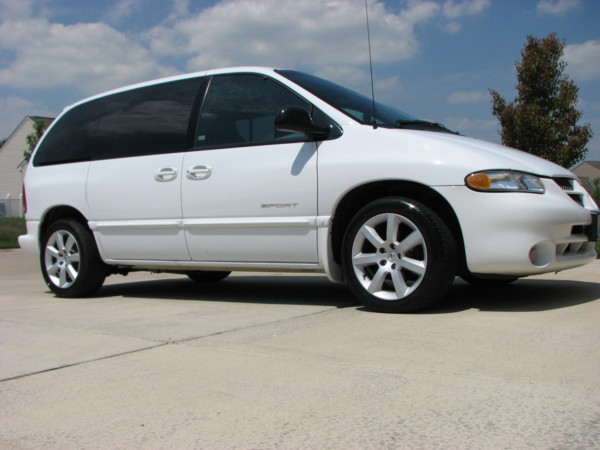

Actually you aren't out of luck if the hub is larger. I put my stock 17" 350Z wheels on my Caravan and all I had to do was machine out the bore a small amount. They fit the Caravan perfectly.
/\ Priceless, lmfao...
Where the 17's belong.

lol that minivan is sweet lol, im pretty sure they will fit on an rx7
I stand corrected. BTW kick *** van LOL!

Wow @ the caravan lmao
Awesome!
you got the tire shine on there too! lmao

nismo caravan?
